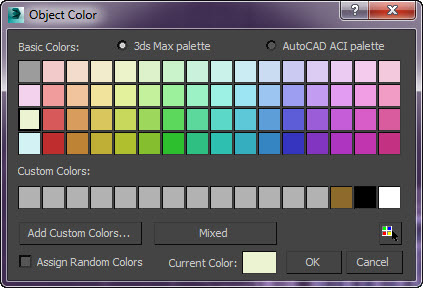

1. Select all objects
2. Click white square box of the 1st image.

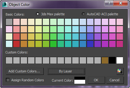

3. Click mixed. That changes to By layer.

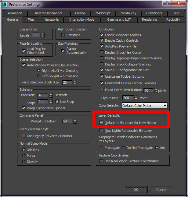

An optional step is to go to your preferences and check the box shown. This will made sure all new objects take on the properties of the layer.
