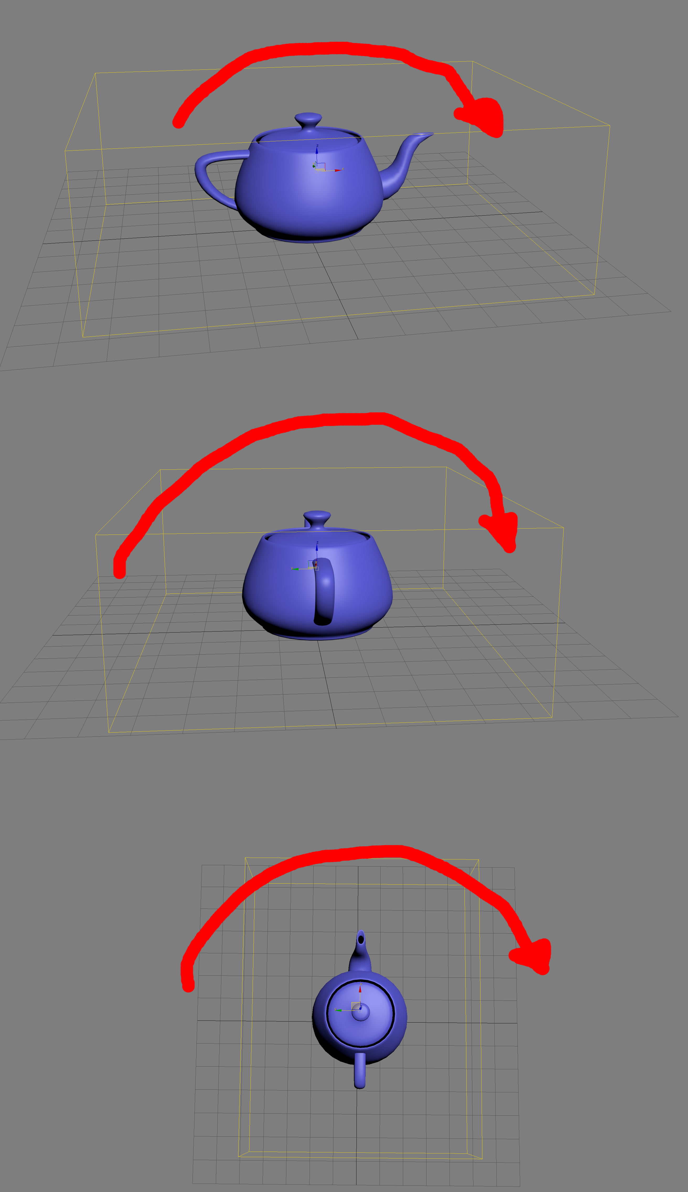

Hello everyone i have an idea for a script that would be very useful, but i dont know how to make it, i think it is a little bit challenging.
I would like to rotate the Uvwmap by the view angle of the viewport, for example 90 degree or 180 degree.
| rotate_by_angle_view.jpg | 1.72 MB |

Ok know i have tried to make it, it works but just for the first rotation, i dont know why :(
does anyone has an idea?
Shouldn't it be like this?
Thanks, now it continues the
Thanks, now it continues the function.
But if i rotate it from the Side and go to the topview its changing the axis.
