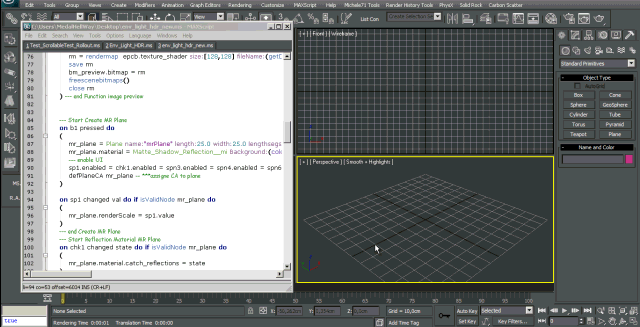

I have completed another script and I'm completing the final steps (debug and more options). Now it is a problem. The script provides for the creation of a obj plane "general" called mr_plane and a map environmet. With its creation of plane (and map env), I active every spinner etc .. because I want it to be created first. Now If I close the rollot and re-open it, the spinner ecc are desabled. I know many ways to refresh parameters ecc, but are now bogged down..
My question is:
How to recognize the presence of the plane (and evironment) and activate all parameters? The problem is if the plane is renamed AFTER its creation and if there exists a map environment different or equal...
Any suggestion is welcome! Thanks!!

Bad news, the your script (thanks again :)) dont work!! The parameters dont refresh... I try the function "defPlaneCA node" on new script very simple:
The function here work well, but in your example, no.
I noticed that at the function (the first time in new script) gave me error "IsKindOf" where he found three but was looking for two!! Very strange because value is tes and class rolloutclass then right. I do not think that is the position of the function in the script is wrong... In your opinion, where is the error?
