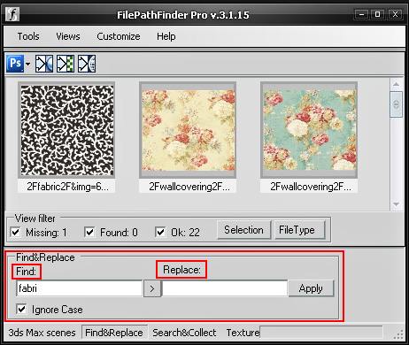

Kstudio · 2012-08-14
You can use the "Find&Replace" opportunity in the FilePathFinder Pro.
