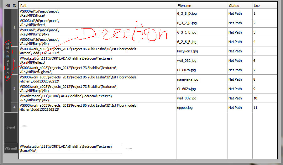

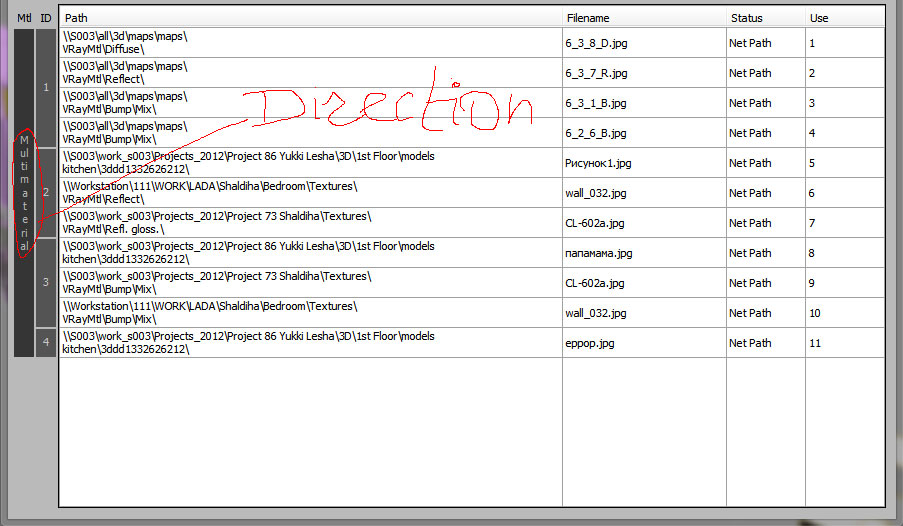

I want to create buttons depending on certain things!
So here is what I need:
fn myfunction=
for i=1 to IDcount do
     dotnetcontrol ID_btn[i] "System.Windows.Forms.Button" width:20 height:60 pos:[27,i*153]
     ID_btn[i].backcolor  = (dotnetcolor 70 70 70)
     ID_btn[i].flatstyle = dotnetobject "System.Windows.Forms.FlatStyle" Flat
     ID_btn[i].text="1"
     ID_btn[i].foreColor = (dotnetcolor 200 200 200)
How to make it work?

how
artrender.info · 2013-04-18
sp.panel1.width = 15
just tell me
how to define the width of the containers and if I can use just one container then let me know how to fill pn with one container. Everything else I understood how to do!
Except this
I thought to draw all buttons like you showed me in this function:
	fn defBtn pnl txt: w:50 h:50 cnt:0 =
		btn = dotnetobject "Button"
		btn.text = txt
		btn.width = 50 ; btn.height = 20
		btn.Location = dotNetObject "System.Drawing.Point" 5 (-15 + (cnt*btn.height))
		btn
Here it is possible to put location and dimensions! In fact I need only one container where I could add buttons!
Is it possible to define just one container where I could add these buttons, or should I make a thin column on the left and one wider on the right where I could add all the buttons?

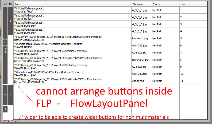

and
artrender.info · 2013-04-17
dotNetControl FLP "FlowLayoutPanel" width:48 height:(table.height-24) pos:[2,153]
inside rollout
I had this function previously
	fn dotnetcolor r g b =
		(dotNetClass "System.Drawing.Color").fromARGB r g b
	fn defCB  dnCtrl btnheight txt: check: =
		dnCtrl.Appearance = dnCtrl.Appearance.Button
		dnCtrl.flatappearance.bordersize = 0
		dnCtrl.margin = (dotNetObject "system.windows.forms.padding" 1)
		dnCtrl.width = 20
		dnCtrl.height = btnheight
		dnCtrl.backcolor = (dotnetcolor 84 84 84)
		dnCtrl.forecolor = (dotnetcolor 200 200 200)
		dnCtrl.Cursor = (dotNetClass "Cursors").Hand
		dnCtrl.FlatStyle = dnCtrl.FlatStyle.Flat
		dnCtrl.TextAlign = dnCtrl.TextAlign.MiddleCenter
		dnCtrl.text = txt ; dnCtrl.checked = check
dotNetControl MtlFLP "FlowLayoutPanel" width:22 height:(table.height-24) pos:[5,153]--column for materials buttons
dotNetControl FLP "FlowLayoutPanel" width:30 height:(table.height-24) pos:[18,153]--column for mat IDs
 if classof s.material == multimaterial then
	cb = dotNetobject "checkbox"
	defCB cb (newbitmaps.count*30-2) txt: (m as string) check:false -- 30 - the height of a datagrid row, newbitmaps.count -- count of textures inside ID
	FLP.Controls.Add(cb)
I don't understand how to use it

even
artrender.info · 2013-04-16
BitmapLister.FLP.FlowDirection.BottomUp
doesn't change anything!
I think I'm doing smth wrong!
barigazy · 2013-04-16
I noticed that whatever I use
BitmapLister.FLP.FlowDirection.TopDown
or
BitmapLister.FLP.FlowDirection.LeftToRight
it does not change at all! I think I'm not writing code corectly
Not change because your FLP with is too small and not allow to cange position of controls. I love to use Panel because I can manualy assigne exact location of .net control. But if your controls change size then FLP is the better choise
does not help also! exactly the same result! May be smth I do wrong!

but I still could not find a solution to align buttons like in the second picture from above
Are you try with FLP horizontal direction direction. I this not works then you need change concept
Let's say
I can use image for label with vertical text - multitexture, but I can't alight buttons
Why do you want to use map to represent simple text.Are you try to add text to button as I show you yesterday?
here is what I achieve

artrender.info · 2013-04-15
May be you have some ideas how to do this:
buttons should update accordingly to textures from datagrid which change.
Here is what I have now
		dnCtrl.width = 20
else
						mt = dotNetobject "checkbox"
						defCB mt (multimatTCount*30-2) txt: ((classOf s.material) as string) check:false
						BitmapLister.MtlFLP.Controls.Add(mt)
and here is what I want:

how to make vertical text orientation for text inside buttons?
dnCtrl.Orientation = (dotNetClass "System.Windows.Forms.Orientation").Vertical
barigazy · 2013-04-15
I never try this, but also I think that buttons or checkbuttons not have that property. Find another solution for for your controls placement. Not try to experiment too much, because your GUI creation process may take several months.
Trust me :)
srry, I've found! SOLVED
I had to use
dnCtrl.margin = (dotNetObject "system.windows.forms.padding" 0)
still the same
dnCtrl.margin = dotnetobject (dotnetclass "padding") margin margin 0 0 --gives error
But I've used
dnCtrl.padding = (dotNetObject "system.windows.forms.padding" 0)
but buttons still appear the same way, at a distance of 6px!
Oh, barigazy!
You're awesome!
but how to remove padding around buton?
artrender.info · 2013-04-14
	fn defCB dnCtrl txt: check: =
		dnCtrl.width = dnCtrl.height = 25 ;
		dnCtrl.backcolor = (dotnetcolor 70 70 70)
	defCB cb txt: "1" check:false
barigazy · 2013-04-14
adjust FLP width 2px wider then buttons width
--put theses two lines inside defCB function
