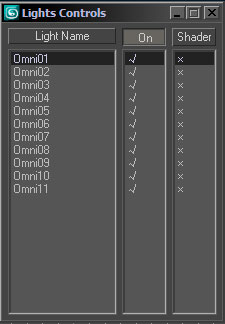

Thank you Budy.I'm trying your Script!
Now I have another means to achive my goal instead of using button and checkbox.
I find listbox is easier to deal with.Here’s the interface of my Lights Controls using listbox.
