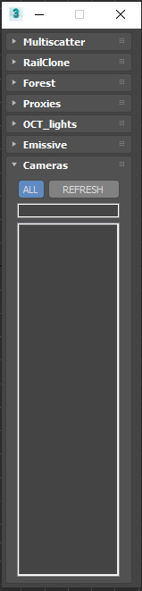

I switch to max 2020 and win10 and I can't move my script window
By titane357 · 2019-08-26
I made some scripts using Rolloutfloater like :
RF = newRolloutFloater "B" 130 620 580 80
addRollout RONE RF rolledUp:true
addRollout RTWO RF rolledUp:true
addRollout RTHREE RF rolledUp:true
addRollout RFIVE RF rolledUp:true
addRollout RSIX RF rolledUp:true
addRollout RSEVEN RF rolledUp:true
addRollout RFOUR RF rolledUp:false
I switched to max 2020 and win10.
All scripts work fine, I can open rollouts and use tools, but I can't move the whole window...
A little square appear at the place of the name when I try....
Any idea ? Thanks.

From what I see the problem is that there is no titlebar inbetween the icon in the left and the min, restore, max buttons on the right, so there is no place where you to place the mouse cursor and to move the window.
1. Make the main rollout wider(the min, restore, max buttons will goes to the right and there will be free space in the titlebar between those buttons and the icon in the left).
2. Remove the min, restore, max buttons from the main rollout if you not need them.
3. Try this: RMB+Click on the icons on the right and you have to see a menu with some options(Move among them).
titane357 · 2019-08-27
Hi, thanks for answer Miauu :-)
I made the rollout wider, so I see what win10 add to the bar....
I try to make solution 2, but as always I failed.
I imagine it is with "style:" but howerver I write it change nothing. :-(
