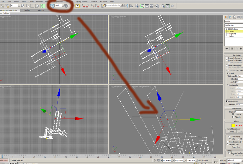

hi all,
i am stuck moving spline knots (vertex) in local space.
i use "getKnotPoint [...]" and "setKnotPoint [...]" functions to get and set knot position but the point3 values are in current working coordinate system.
how can i (relative) move a knot in local space in the desired axis by a specified value?
any hint into the right direction is really appreciated.
thanks in advance
-le1se
Comments (2)
le1setreter · 2012-02-28
forgot to thank you, anubis.
i had very less time the last days. fast testing with coordsys local did not work for me but maybe i did something wrong. will give it a decent try as soon as possible and come back if i still need help on this. thanks.
Anubis · 2012-02-24
in coordsys local
should works
