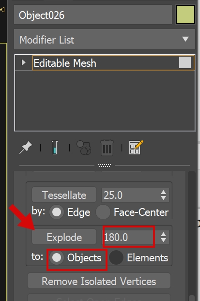

Explode Mesh to Objects
Would this trick allow to Explode EditableMesh to the Objects?
P.S. this is fastest and most efficient way to get thousands individual objects from object elements
