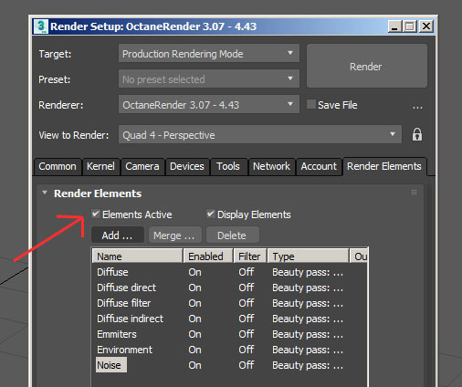

I can activate or deactivate render elements but I don't know how to check if render elements is active or not.

My apologies, I wasn't precise enough in my question...
In fact it is the render element MANAGER that I have in mind.
I made a check button "CELEMENTS":
on CELEMENTS changed theState do
if CELEMENTS.checked==1 do
local reMgr = maxOps.getCurRenderElementMgr()
reMgr.SetElementsActive true
if CELEMENTS.checked==0 do
reMgr.SetElementsActive false
I want to update its state checking if render element MANAGER is active or not...
miauu · 2018-01-30
	elementMgr = maxOps.GetCurRenderElementMgr()
	res = elementMgr.GetElementsActive()
	format "Active: % \n" res
titane357 · 2018-01-30
yesssss !!! Thank you very much, works fine ! :-)
