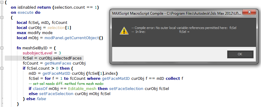

[Edit] Ok, new version is out, cheers!

here is message when i try to run script
max2012x64
here is...
lets hope it is what you need:
http://www.scriptspot.com/3ds-max/scripts/selectbymaterialid
cheers!
