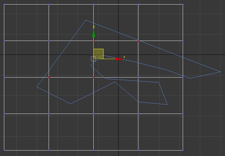

Is is possible for someone to make a script that selects all mesh vertices that are inside the boundary of a spline, when we are working on top view, (meaning only x,y not Z coordinates). This might be useful in other views also I guess.
The workflow might be something like:
1. Go to prefered view.
2. Select Mesh
3. Select Spline
4. Run (and corresponding vertices wound be selected)
In a more complex version same thing could happen with faces and polygons.
Could't find something similar...
Thank you !

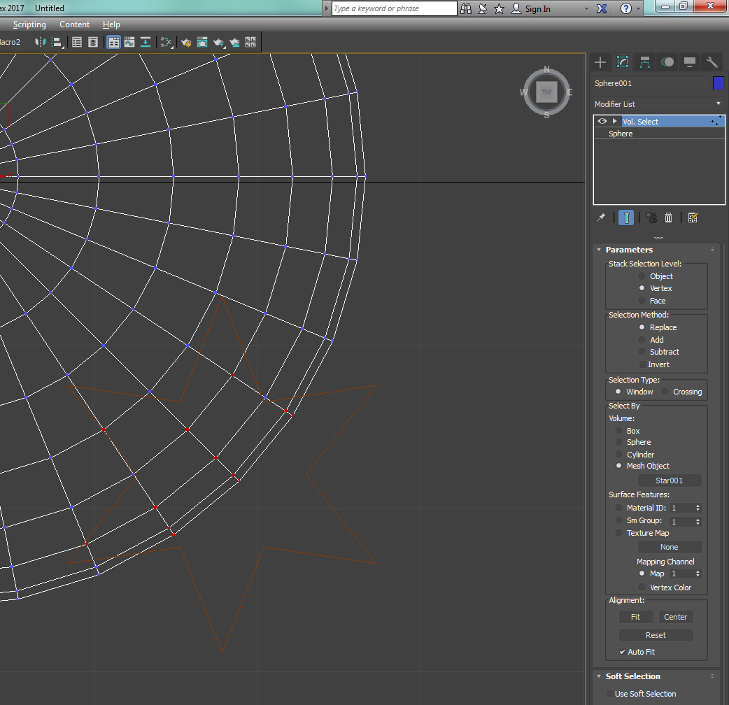

vusta · 2016-09-22
...but hey I can't force it down your throat...
Nice!
TsveTan · 2016-09-23

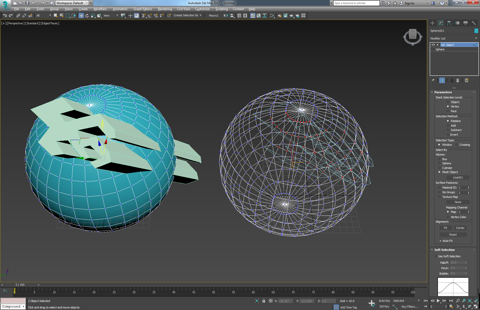

I forgot this modifier. Does it work in a random direction for example along the normal of the 2D splineshape (that is randomly rotated)? Does it work correct for a more complicated shape (like the first image of lga)?
odd shape spline...
vusta · 2016-09-23
random rotation...and there's no need to have the extrude thicker than the object...if the extrude is thin...it simply selects according to whatever falls within the smaller volume..
