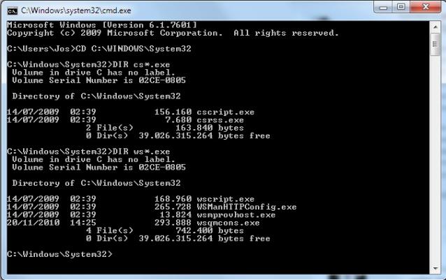

in my pc C is the system drive, so quick test whether this files exist using the console is - StartMenu > Run > CMD, then in the console:
CD C:\WINDOWS\System32
DIR cs*.exe
DIR ws*.exe
it works with excel..
jos · 2012-01-23
Thanx again. I found those exe's. I linked js fie to wcript.exe and i can execute the js file. but i get an error to "automation server can't create object" i took a printscreen from my cmd window:
so the javascript thing is solved, but what should I do for photoshop? (I tried it with illustrator to, didn't work)
