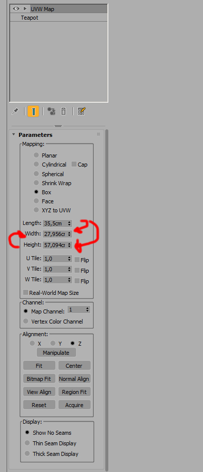

Hello everyone,
i have a question, is it possible to switch the lenght parameters with the width and height parameters in the uvmap.
F.e. the lenght is 100 and the width is 50, so the script needs to switch the parameters to length:50 and width:100

miauu · 2020-04-07
Switch length and height:
	global rol_miauu
	try(destroyDialog rol_miauu)catch()
	rollout rol_miauu "Switch UVWMap L/W/H"
		button btn_switchLW "Switch Length and Width" width:150 align:#center
		button btn_switchLH "Switch Length and Height" width:150 align:#center
		button btn_switchWH "Switch Width and Height" width:150 align:#center
		on btn_switchLW pressed do
			selObjsArr = selection as array
			if selObjsArr.count != 0 do
				for o in selObjsArr where o.modifiers.count != 0 do
					if classOf o.modifiers[1] == UVWMap do
						swap o.modifiers[1].length o.modifiers[1].width
		on btn_switchLH pressed do
						swap o.modifiers[1].length o.modifiers[1].height
		on btn_switchWH pressed do
						swap o.modifiers[1].width o.modifiers[1].height
	createdialog rol_miauu
