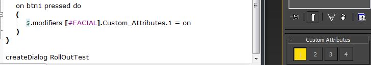

I am new in Maxscript, I want to be able to turn ON and OFF a check button in an attribute holder (costumed attribute)created previously with the Parameter editor . I am doing an UI that collects some custom attributes from different objects.
But when I tried to check the syntax in the max listener and paste it in the script editor, this pops up:
No ""="" function for ((prop Custom_Attributes ((prop modifiers* (%getDollarSel()))[#FACIAL])) 0.1)
and the script for the button is this:
on btn1 pressed do
$.modifiers [#FACIAL].Custom_Attributes.1 = on
where the number 1 it's the button´s name
and FACIAL the modifier's name (attribute holder)
Any ideas??
Thank you!!!

In this case I would do :
SetProperty $.modifiers[#FACIAL].Custom_Attributes #1 off
get button state:
GetProperty $.modifiers[#FACIAL].Custom_Attributes #1
The reason is: usually numbers can't be used as variables in max scripts.
Here 1 came from button name but you can't just call it by 1
If the name of button is "Param1" or even "P1" then you can use your way:
$.modifiers[#FACIAL].Custom_Attributes.P1 = on
Hope it helps.

It worked!! you were right, it was just the name. It's better not to mess with values that can be taken as variables.
