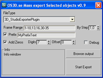

Try the latest version of the script... I have uploaded this to the "normal" scriptspot script bank too... but I thought it would be easier to find here now...
This has some additional features regarding exporting sequences out from max... but in your case just put the sequence to: 1
and set the export format to:
DWG_ExporterExporterPlugin (yes that is the correct name ;-)
when the dwg settings open... DONT uncheck export selected object.. it is checked by default, just keep it like that.
this worked for me when I tried it.

I have made a new version of
I have made a new version of the script that supports exporting obj sequences..
http://scriptspot.com/3ds-max/mass-exporting-of-selected-objects-in-3dsmax

I have uploaded a new
I have uploaded a new version that might be a little annoying. Depends on how many objects you wan´t to export.
Tip just hold down the Enter key once you have selected the correct sttings...
OK... this is caused by the same problem as the former issue. Since the export plugin is old and not 100% compatible with the current version of 3dsmax 2009. It doesn´t remember the setting of the Binary/Ascii setting from the first object. It returns to its default value.
But if I display the prompt for every object you export it remembers it. Very strange and stupid. The only half decent thing is that I show you the binary/ascii prompt for every object you export and all you have to do is to press ENTER to continue to the next object.
I am very sorry that I can´t solves nicer right now.
One solution might be to look for another STL exporter plugin for 3dsmax if that exists and hope that it has better maxscript support.
