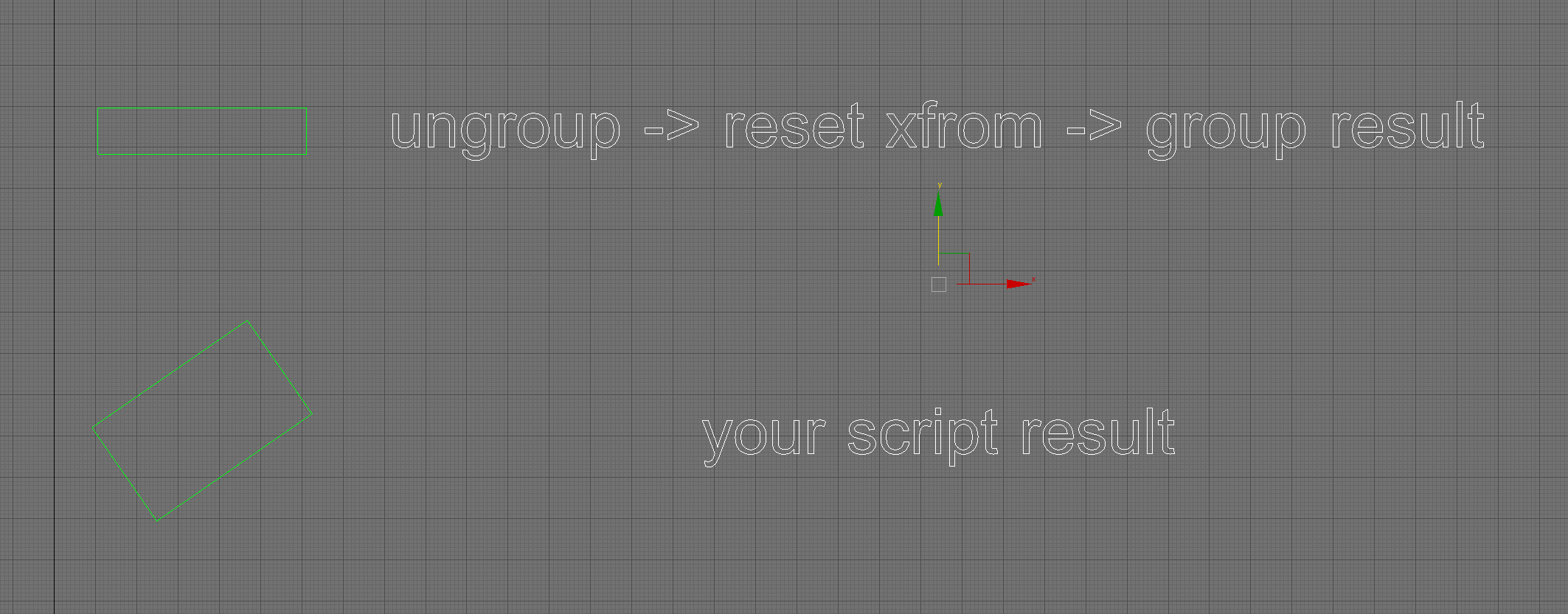

but there is problem
can you check attachef image
first image is manual work , that is good
but your image is still not .
pls can you compare file
Reply to dussla
Branko Živković
Object on top is the single object, you attached all elements and centralized pivot.
You didn't mention that.
The uilding on the bottom has multiple elements with offset pivot positions. My code only resets pivot orientation but not affect pivot position

top is only sample result
you can see bouding box
i want that in group
i attached again
sorry for many ask
ps : sorry i did not center pivot ~
this need center pitvot
