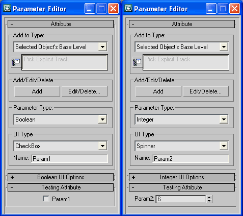

Hi. Not sure if I'm posting in the right section, but I need some help.
I have wired visibility from Box06 to Point01 that has an attribute holder or "Param1" which has spinner integer with value ranging from 0 to 15. Now I want Box06 visibility only to to be 1.0 when Param1 value is at 6, otherwise if its on 2, 4, 1, 12, or whatever in that range other than 6 then Box01 visibility is at 0.0 value. What should I write in the expression after I have wired these two. Or are there any other ways to go around this?
Comments (2)
Panayot Karabakalov

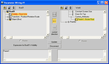

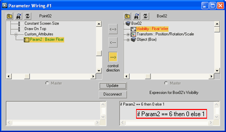

If looking for another way, you can use Boolean with checkbox instead of spinner controll. Then if checked visibility will be 1 and 0 if uncheked. In this case do not need to write any expression. But if you get value 6 from other event or script and need to wire by spinner, then write:
if Param2 == 6 then 0 else 1
-- Note: in my example attribute param is "Param2"
* And for more clear see attached screenshots
(in "wiring_var2.png" I zoomed a little expression to see more clearly)
