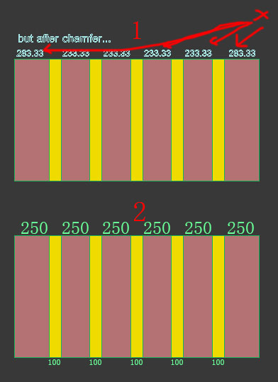

Divide Evenly? like attachment show, one box with a width, editpoly, connect, chamfer, each part cant get even width...any method or script can simple click and get the even part?or like i input a number of part, and yellow color's width, then get the correct result?

cmjohncheng · 2012-05-12
Thanks, but maybe u misunderstanding my meaning, ur script is like after connect, i thinking to get the result after chamfer, like picture show, erm, i got one box, width is 2000, divide by 5 = 333.33, ur script is same, if type 333.33 by ur script can let it auto divide by 5 too, but still hvnt get the result after chamfer.
after divide by 5, i need that 5 edge chamfer(let say i input a number(like picture is 100), but pink color part after chamfer should get the same width.
