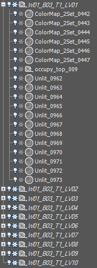

I'm searching for script that making group from selected "Dummy"(with all childrens),
and renaming group with the "Dummy" name.
Ideal, that if i selecting a lot of "Dummys" and when i run the script, It makes groups from all "Dummies" i selected (keeping above rules of-cause).
I'll be very appreciate if some one can help my with this kind of script.
I'm working on big amount of small game assets, in is over 100 small buildings i have now, and a lot to make.
I Exporting using "Batch Export/Import" Script from Jos Balcaen, so i need all my assets being in separated groups each other, with right naming convention.
My hierarchy for each asset is like:
"Main Dummy object" > Meshes & Nulls
To make script working right, i need manually put all "Main Dummy object" in Group, then rename the group,with the same name dummy has, and i must do it manually for all assets from my scene.
