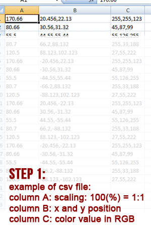

The spread sheet has a title line and then each row shows (size;x,y,z;r,g,b;rotationx,rotationy)
the size of the object compared to the original (assuming the original object to have a size of 1 unit).
the x,y,z coordinates of the center of the copy of the starting object.
the R,G.B of the object to be placed.
It then shows two columns "RotaionX" and "RotationY" the rotation of the object, this was not mentioned before because I am unsure how to express it for the 3d world, but for objects that are not symmetrical it would be good to be able to rotate them about 2 axis.(This Rotation aspect is a nice to have thing and wouldn't greatly effect me at this stage, In fact in the CSV the Rotation Y is set to zero for all the rows.)
If my understanding is correct if we started off with a clear glass sphere as our original object; your script together with this csv should place objects pretty much in one plane - like marbles on a disc (except the tops of the marbles are alligned rather than the bottoms) with each marble coloured. The marbles nearer the centre would be smaller than those further away.

le1setreter · 2010-11-11
nicksoph, i have roughly done the script. its not cleaned up and optimized yet..
script, demo-csv and mini-tut-animgif is attached. have fun.
