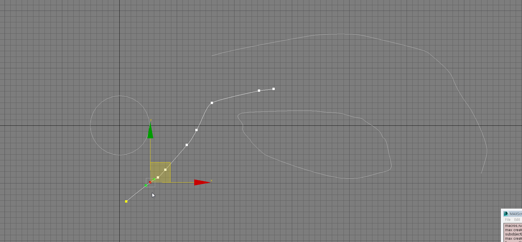

dussla · 2019-01-09
I run your code and get an error
So I run it again with my code.
If you look at the attached image
1. Works well with open splines
But with closed splines, the operation sometimes fails.
What is the reason?
2. When tested in a circle, all are selected
But I do not use these shapes because I do not use them
3. For example,
There is spline with knot1 ~ knot20
If I select knot 1 ~ knot 10
I want to switch the selected vertices between them to segment select
But you do not have to consider the direction.
