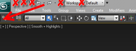

Can anything be done via maxscript to get rid of the mess on the left hand side of the toolbar, and put the undo redo in their legacy position? thx
Workspace and undo redo buttons
By asymptote · 2012-10-09
- 09-10-2012_11-44-52.png — 09-10-2012_11-44-52.png21 KB

barigazy · 2012-10-09
If you want to put undo redo in their legacy position then do it manualy (drag&drop Undo and Redo Scene Operation icons from
Customize User Interface dialog to Main Toolbar).I not recommend using maxscript for that.
If you want do close InfoCenter dialog and dialog on left side also
(where is new,save,undo,redo etc.) then you can use this function
(i simplify original Pavel Vojacek version )
fn closeQAT_ICS =
controlshwnds = windows.getChildrenHWND #max
QAT = (for c in controlshwnds where c[5]=="QATHwndSource" collect c[1])[1]
ICS = (for c in controlshwnds where c[5]=="InfoCenterHwndSource" collect c[1])[1]
UIAccessor.CloseDialog QAT
UIAccessor.CloseDialog ICS
closeQAT_ICS()Put this code in maxroot>scripts>startup folder If you want to permanently get rid of this dialogs
