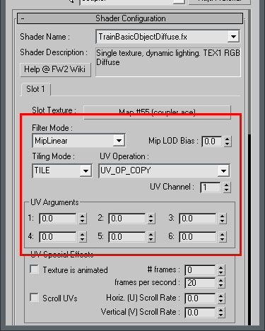

I've managed to grab some of the extended values - those that showed up when I queried the materials using getPropNames, but that's only 8 of the values out of a possible 50 or so and I'm not sure how to get the others.
I've attached my script so far - don't laugh - it's very rudimentary. But if you look at the attached screenshot, I'm trying to figure out how to find the values for things like the shader name, the UV arguments, filter mode and things like that. I've tried apropos() with some values but nothing obvious is presenting itself to my queries and now I'm stuck.
