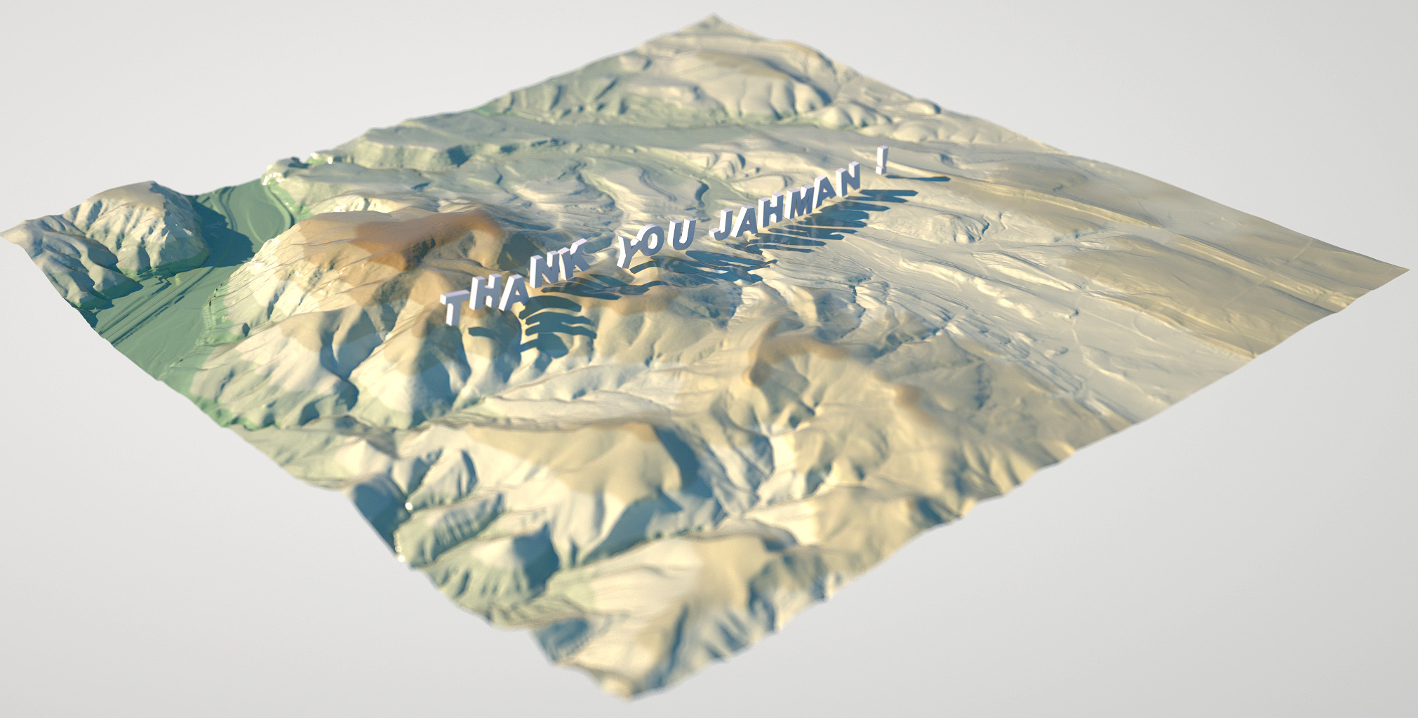

WAW !!! Thank you soooo much
WAW !!! Thank you soooo much Jahman !
Works at lightspeed, and yours is working ( mine was repeatiting same row of values )
I can open all files now, and now I'm going to try ( ah ah ) to make the script more usable for my work.
