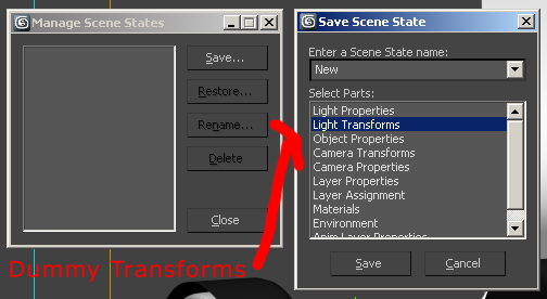

I have create a 3D Scene with Manipulators those affect to multiple Dummy Objects. Manipulators change the position of the Dummy objects with linked other objects. Now on "Manage Scene States" I wanted to create different States. These States, I wanted to insert into "Batch Render" Dialog.
The Problem is, that Scene States save no Positions of Objects or Dummy Objects.
But it saves Light Positions over the Part "Light Transforms". Is there a possibility to duplicate these Part and change it to "Dummy Transforms" or Object Transforms?
If this is not possible, there is a way to convert the properties of the Dummy Objects into Light Objects?

| dummy_transforms.jpg | 77.83 KB |
