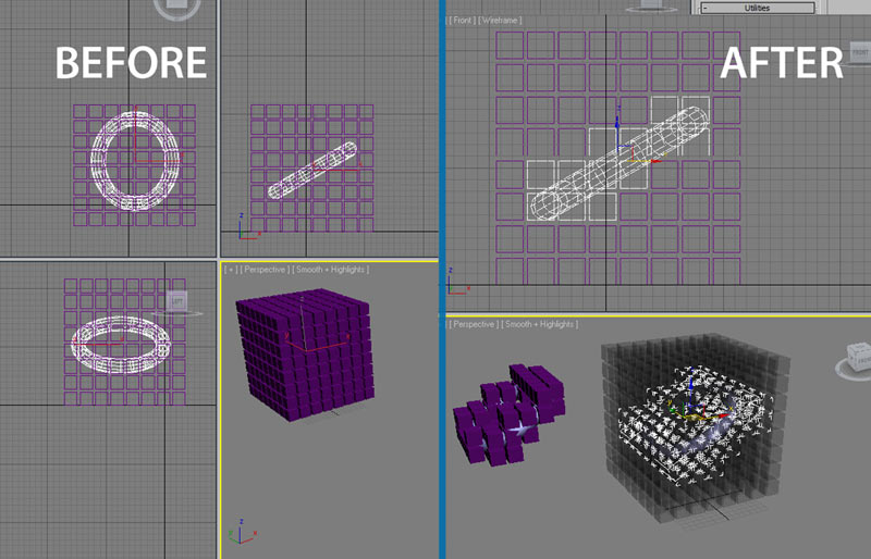

I try to make Box array and make torus intersected many of boxes. When i use script when all selected it slect only torus.
If i select only torus and run script - it make nothing selected.
(and if i try add some tolerance it freez 3d max, i use 2011 64bit)
Maybe i do something wrong?
I try to illustrated what i need in attached jpg
It must select all boxes what interesepted with "master" object - torus in this example.

I've got a script that does just that. Check it out. Let me know what you think. Ways to improve and what not.
http://JokerMartini.com/2011/10/10/geo-grand-prix/

if you only test for their
if you only test for their bounding box, this is very easy. if it has to be more precise, which in your case i fear it has to be, it gets more complicated and i dont know how to do it right now. i think you might have to raytrace from the surface of one object to another ones and see if you hit, which would be very costly on performance. hm... maybe someone else has a smart idea :P
