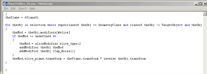

Hey I just watched this exact
Hey I just watched this exact thing on the Adv Maxscript DVD, im a newb so dont really understand it but here is a screenshot of the script.
This is the full line of the 'for' loop as it is cut off in the screenshot:
for theObj in selection where superclassof theObj == GeometryClass and classof theObj != TargetObject and theObj != thePlane do
The DVD also goes on to tell you how to make the slice update automatically as you move the plane, let me know if you would like this part too :)
Note this is not my work but that of the guy from the DVD!

Hey Vapourise,
thank you for your email, but unfortunate this is the other way around i want.
In your example the slice modifier of the box is aligned to a plane, but i would like to have the plane aligned to the slicemodifier of the box.
However you gave me a hint in the good direction and this is the piece of good i needed :-). thanks
theObj = $Sphere001
theMod = theObj.modifiers[1]
$plane001.transform = theObj.transform * inverse theMod.slice_plane.transform
