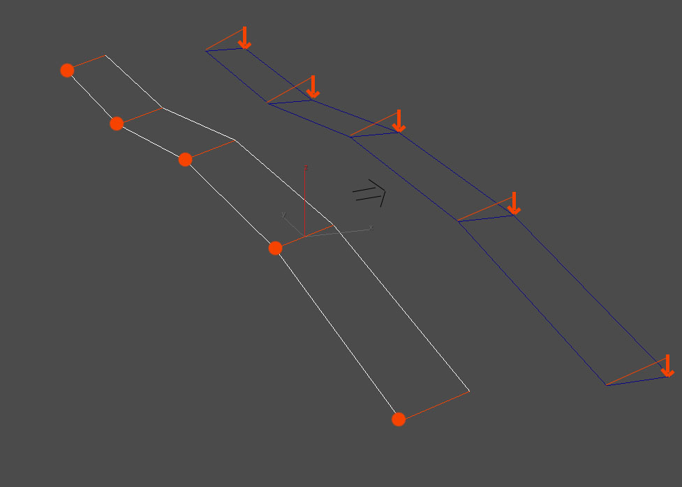

Align selected ring edges to selected vertex z value
I have a road for exemple where vertex are not at same z values at the right and left side.
I select all the edges along the road (a ring )
I select all the vertices I want to stay in place
I run the script and all the edges become horizontal.
That is what I want.
But I can't manage to find how to write in maxscript :"pp[1] exist in selP" in the script below. If somebody could help.
Thanks :-)
a = $ selE = a.EditablePoly.getSelection #Edge as array selP = a.EditablePoly.getSelection #Vertex as array for ss in selE do ( pp = polyop.getEdgeVerts a ss as array if "pp[1] exist in selP" then ( polyOp.setVert $ pp[2] [ a.verts[pp[2]].pos.x , a.verts[pp[2]].pos.y , a.verts[pp[1]].pos.y ] ) else ( polyOp.setVert $ pp[1] [ a.verts[pp[1]].pos.x , a.verts[pp[1]].pos.y , a.verts[pp[2]].pos.y ] ) )

Thank you very much !! Works
Thank you very much !! Works fine !
One day I will do something by myself ! :-)
