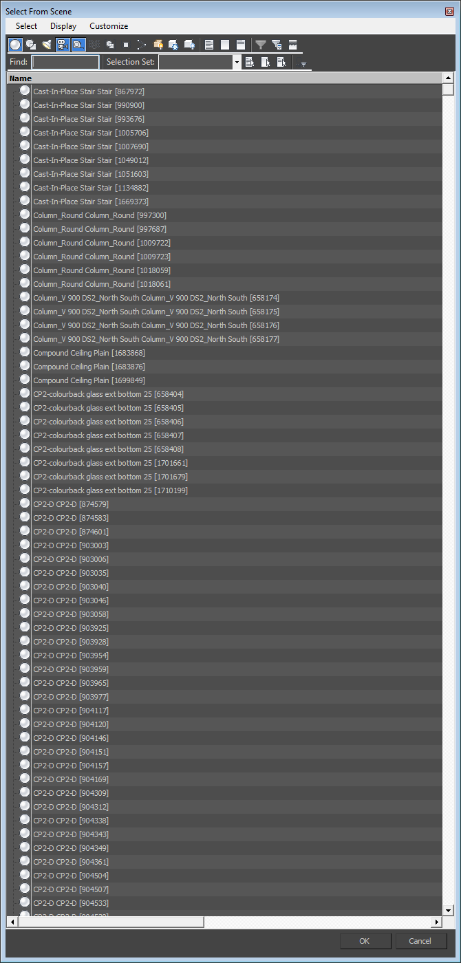

Hi guys,
I'm often dealing with imported Revit files.
They contain more than 20k objects.
I need to attach them, by name, but they have numbering at the end, CF Attached file.
Would it be possible to attach the objects that have the exact same name but disregarding the last numbering bit? At least it's using the brackets so maybe we could use that to exclude from the name?
It has to stay a editable mesh and not be converted to poly as this leads sometimes to bad geometry.
Thanks a lot for your help.
Cheers
Stan

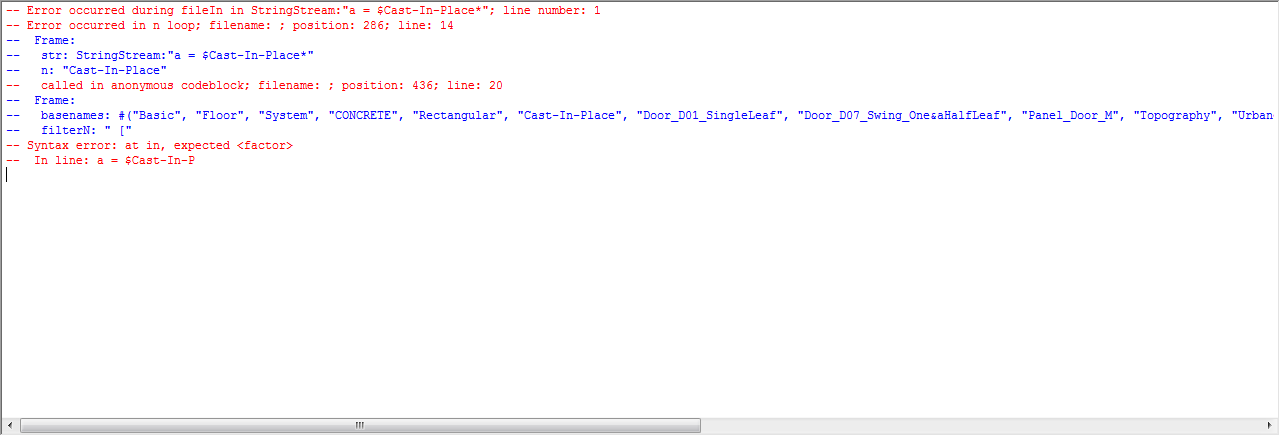

Hey mate, just got a little
Hey mate, just got a little error.
Thanks for your help, really appreciated!
Stan
ah, true, it did not work for names with spaces
this one should work for all kind of names:
