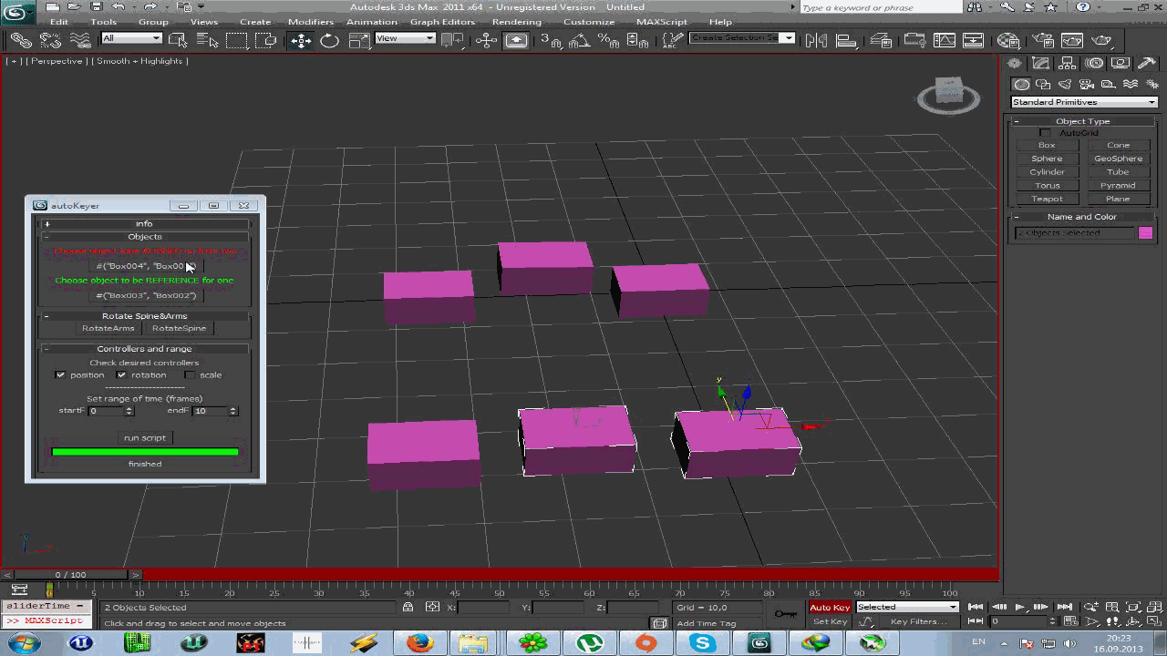

The result is same(working with 1 selecetion on each menu) only change is that http://i.shotnes.com/a/09/zw1rkbus.ko3_522e5062a76e4.png
object's that where seleceted are displaying in text box.
But if there is more then 2 objects selected i get this error.
If you can help with it please, i waisted a lot of time on this issue and ruined a project because of time it taked.

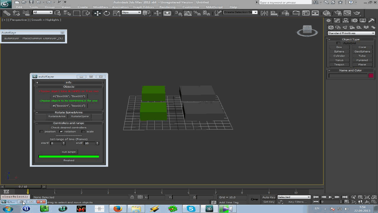

Rotation Result - far from
but its far from what i should be

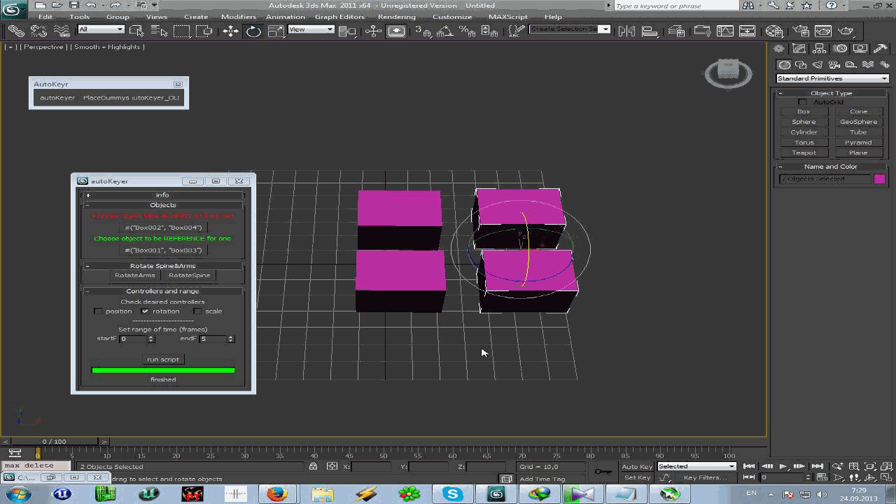

Here is result
Autokeyr For multy objects
But i still can't figure out how to make same thing for orientation, maybe someone will help me out again ?

the result give me for example Box001 orientation transferred to both box003 and box004, but should be Box1 to box3, box2 to box4, like for translation.
Autokeyr For multy objects orientation
How to make this working ?, it would be realy good tool for animation transfering , if it would has this option.

http://i.shotnes.com/a/11/k12fylci.2fz_522fb49888740.png
this solutin cant be appled(For this script, the only reason i use it - it make perfect position and anim keys), it has 2 buttons, for storing selection for array 1 and array 2.
Then it has add key function http://i.shotnes.com/a/11/ymob5bxi.zh0_522fb558bc135.png
That is problem i guess, because it designed only to add key for 1 object(that where selected on alignObjects button.
Barigazy
Could you give me hint(script Code) how to add keys for bouth objects in selection 1 array.
If i'm wrong correct me, i'm less skilled in script writing.

DolVai · 2013-09-10
So any Help, i need to make this script usable for multy objects, like shown on screenshot http://i.shotnes.com/a/09/zw1rkbus.ko3_522e5062a76e4.png
Animatin From LeftArm is assigning to dummy017, anim from Leftforearm is assigned to dummy018.
I'm not so sure how to do this, i'm less skilled in max scripting.
