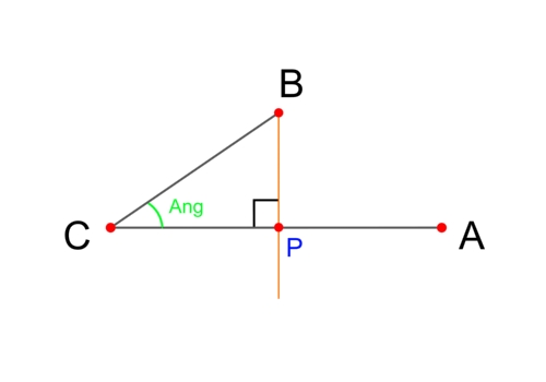

hi, i don't agree guys,
hi,
i don't agree guys, there's a little problem with u'r reflexion, when we talk about angle , we need 3 point de get an Angle, the angle between 2 point is always equal 0.
So, u'r function calculate the angle between u'r 2 points and the 3rd one wich is the point[0,0,0].
To calculate that angle, u need to ask Mathematiques person, i can past time to find it 4 u, but it'll take me time, u can get it quickly by asking a Teacher of mathematique in university, and reply it in max.
if u'r good in math, the idea is :
we have 3 point A,B,C : to calculate the angle "ANG" between A & B at the point C
1st- Calculate the position of the point P wich is the projection of point B on the line (AC).
2nd- Now, the angle ANG between A & B at the point C is the same of the angle between A & P at the point C, the Difference is : The triangle APC have a perpendicular angle at the point P not the triangle ABC, so it's easy to calculate the angle because :
Cos(ANG) = CP/CB --(distances)
Sin(ANG) = BP/CB
we know the poin3 of all points, wich mean we can calculate distances between them.
then your angle:
ANG=acos(CP/CB) and ANG=asin(BP/CB)
i gived u a small drawing to understand. Good luck

in this case use: p1 =
in this case use:
p1 = [0,0,0]
p2 = ($Point02.pos - $Point01.pos)
