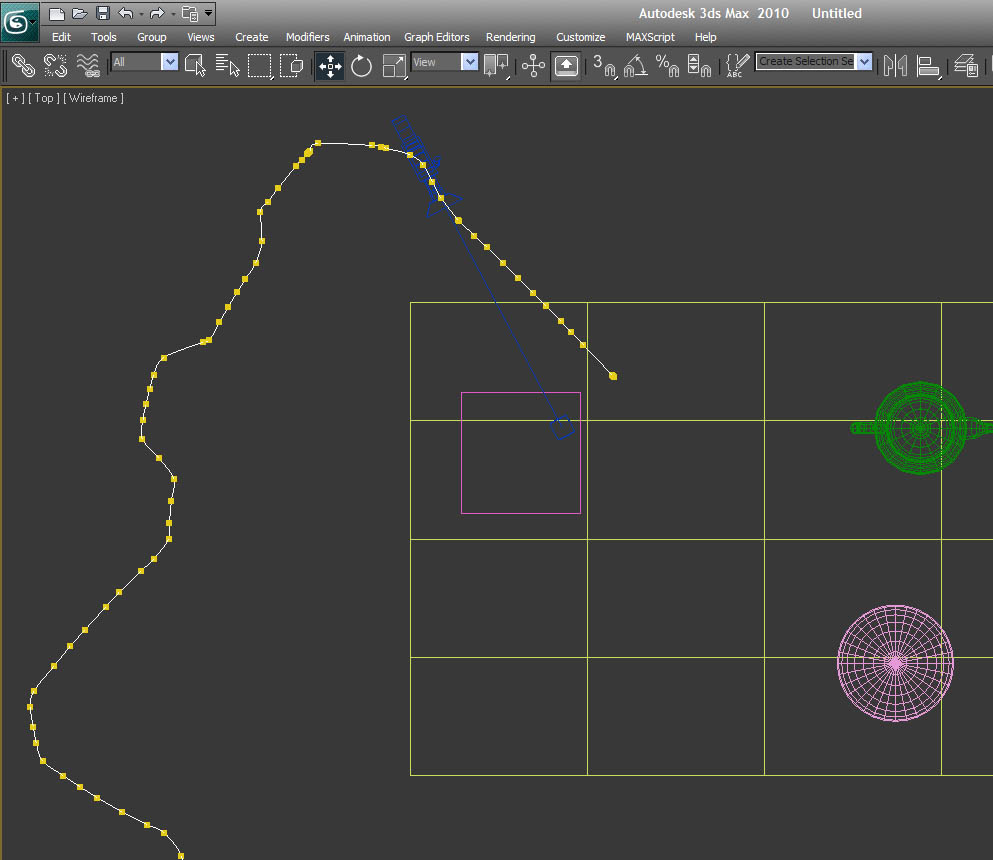

I've been trying to make a camera create a spline when i move it ....in other words the idea is to make the camera behave like a pencil that draws a spline...

-move the camera with the move tool and keybord arrows
-max generates a list of points with x-y-z values
-the points are connected with a spline when the user hits enter
-i guess it could be like, function move tool calls function create spline, when the camera-line objects is moved from a to b, a x-y-z point is generated....enter to finish translation of the camera...create spline from list.

Hi sinok.... thanks for
Hi sinok....
thanks for taking the time.
Your explanation referes to a regular animation of a camera on a spline.
That is clear.
But i want to do it the other way around.
1-create a camera
2-move the camera so it generates a spline
3-so afterwards i get a plan view of the path the user generated while freely moving on the scene.
4- i dont need to previusly tell the user where to go....but i need the user to tell me where he went.
hope its kind of clear.
thanks again.
best
