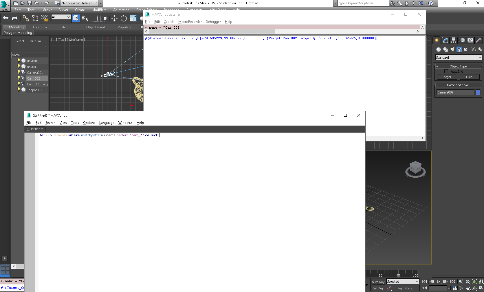

Hi, I ran the code in a simple scene with some cams and it works for me (see image). Are you sure the error is not in the rest of your code (could be a 'logic error' also)?
