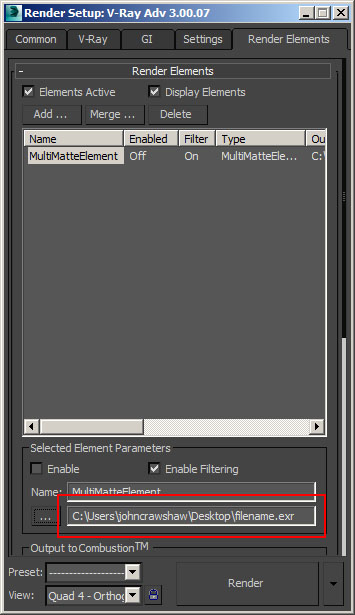

Can you explain a bit more or show some screehots.
I not understand what do tou mean by "maximum element filename"?
Attachement
Not a problem. I've attached an image with the filepath I'm looking at counting and seeing if it is over 256 characters.
