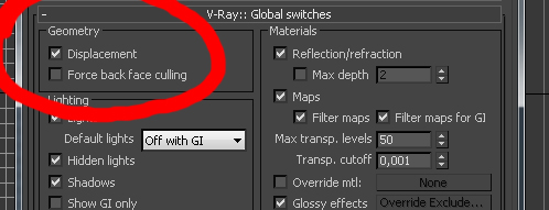

uncheck
only thing I can say is to uncheck the geometry displacement mode from vray global switch.
or in maxscript try
vr.options_displacement =False
and this will not disable it from your materials. only on render it will disable the displacement.after a while if you want it back, check it again
