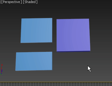

i made this , pls check ~
i made this
but if i esc press , there is no "add modifier" function for undeifined
pls check again
sorry for many question ~
while not keyboard.escPressed do
measureLine = startObjectCreation rectangle returnNewNodes:true newNodeCallback:setColor
addModifier measureLine[1] (extrude amount:100000)
convertToPoly measureLine[1]
select (for obj in objects where intersects obj measureLine[1] collect obj)
deselect measureLine[1]
bigbox = selection[1]
ProBoolean.createBooleanObjects bigbox measureLine[1] 2 0 0
ProBoolean.SetPlanarEdgeRemoval bigbox 3

I guess you don't really need while loop at all
