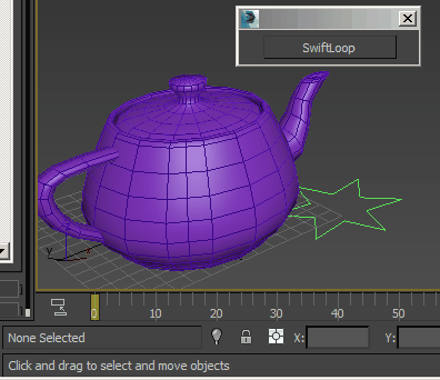

How can I make checkbutton swiching off by pressing right mouse button ?
Hi!)
While I pressing checkbutton it loads the macros,
if i press right mousebutton macros stops working but checkbutton stays on.
Can it be switched off by pressing it twice.
Thank you in advance
rollout RL_Test "Test"
checkButton 'ckb01' "Swift Loop" width:74 height:22 align:#center
on ckb01 changed state do
macros.run "PolyTools" "SwiftLoop"
createDialog RL_Test
