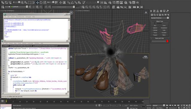

local bgWorkerThread =
this code basically runs some code async || does it in the background
your code belongs.. not to me, but inside the function and can be given back to the main part but for that you need to check the bgworker in intervals for the result (if the function is done running) wich makes the whole thing slow again..so i'd advise against that. simply put you gotta make sure everything is done inside the function and you dont need any result returned, have phun
edit: just freeze all nodes at the beginning and subsequently unfreeze them as your done with the changes to each one.. that way you wont create a singularity :P

Thanks for your efforts! Ive
Thanks for your efforts! Ive put everything except the "getSavePath" command and your dotnet code into the function, and it will work correctly as before, but unfortunately max still freezes afterwards for like 2 minutes (in a testscene with just about 10 objects and materials!).
Why does it freeze at all?? Really pisses me off at the moment...
Oh and sadly I ignored your tip to freeze all objects, and now have to deal with a supermassive black hole sucking up my viewports

hmm you could always put it in a function and run it async with .net so your max wont freeze up..
