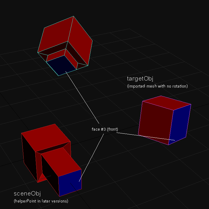

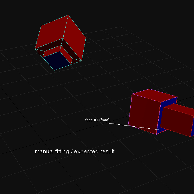

I'm working on a simple import plugin, that imports custom mesh from another app into 3ds Max. In the 3ds Max scene I have a helper (a cube for testing right now) and I need to fit the position and rotation to another one (same size, 6 polys) which is imported. This proves to be extremely difficult for me, and while the position is no problem at all (sceneObj.pos = targetObj.pos) I'm totally lost at matrix3, eulerangles and quat values. And (sceneObj.rotation = targetObj.rotation) is not an option, as the simple imported *.obj file has NO rotation at all.

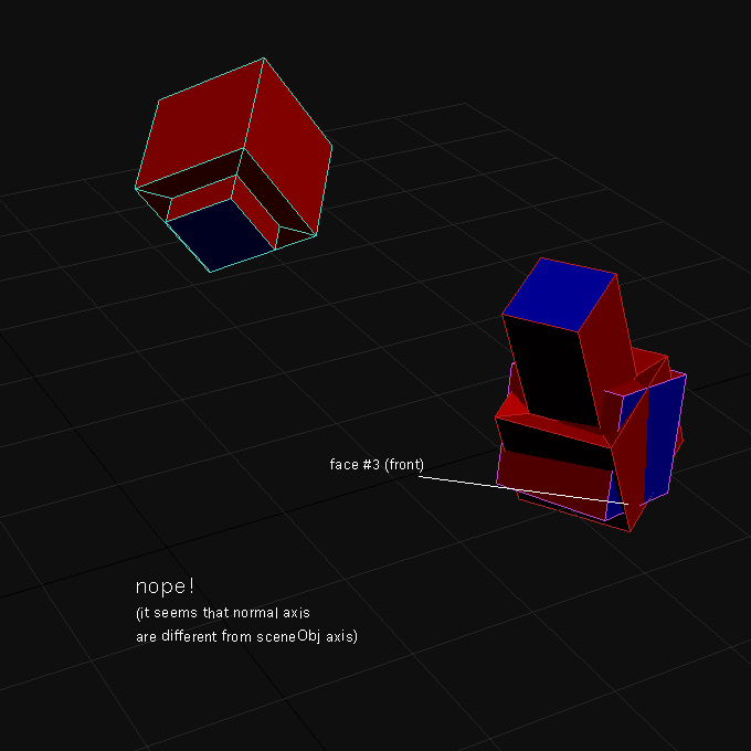

So - I've thought that getting the matrix3 of the normal of face 3 (front face) of the targetObj. I managed to somehow translate the rotation to my scene object but I think the axis are all wrong - some of them keep the sceneObj aligned properly, while when targetObj orientation changes it rotates the sceneObj in the wrong direction / along wrong axis.
Code:
fn getAngleFromNormal targetObj sceneObj = ( --RESET sceneObj ROTATION oldTranslateMtx = transMatrix sceneObj.transform.pos oldScaleMtx = scaleMatrix sceneObj.transform.scale sceneObj.transform = oldScaleMtx * oldTranslateMtx mtx = matrixFromNormal (polyOp.getFaceNormal targetObj 3) sceneObj.transform *= mtx eu = mtx as eulerangles rx = eu.x ry = eu.y rz = eu.z sceneObj.rotation *= inverse (eu as quat) sceneObj.pos = targetObj.pos )

http://i.imgur.com/XHDe9ic.jpg
http://i.imgur.com/89LRbv9.jpg
http://i.imgur.com/cA0YU5D.jpg
