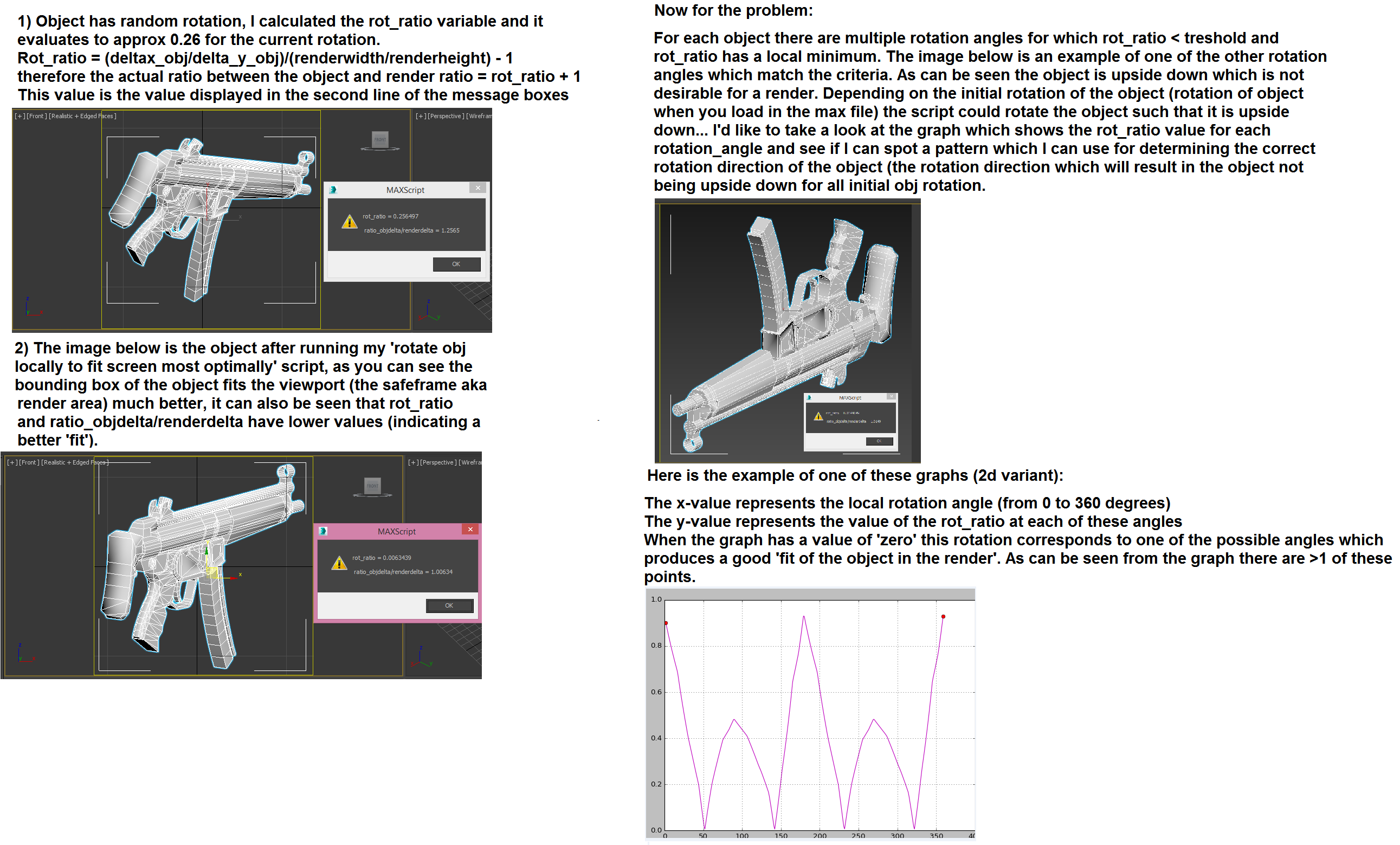

Please take a look at the attached image "rotate_for_best_fit.png" :)

This script is part of a rendering script I am working on, the purpose of the rendering script is to rotate an object in such a way that the object 'fits' the best inside the view to be rendered. I wrote a script to do this because I want to make preview images for a lot of objects so doing it manually would take a lot of time.
Explanation regarding render script:
I have defined a variable 'rot_ratio' (stands for rotation ratio) which calculates the ratio between the object's (delta_x/delta_y) and the aspect ratio of the screen (renderwidth/renderheight). When this variable is equal to zero the aspect ratio of the object's bounding box matches the aspect ratio of the render frame and thus the object is rotated in such a way that it makes optimal use of screen real estate (which is what I want). The closer the variable rot_ratio's value is to 'zero', the better the use of screen real estate is.
Since I am rotating my object in steps of finite size (for example 1 degree steps) it will be very unlikely that my variable will ever reach the exact value 'zero', for this reason I've implemented a threshold value and whenever the rot_ratio variable is lower than this threshold (and when the function rot_ratio reaches a local minimum value) I can confidently say that the current rotation has a good use of screen real estate.
There is one problem with this method though, for each object there are several rotation angles for which the rot_ratio variable's value is under the treshold (since there are several local minima in the rot_ratio function which are under the treshold). Some of these local minima (rotations for the object which result in rot_ratio < treshold) result in the object being 'rotated too far' (image the object is rotated 179 degrees with respect to the local Y-axis, the object would then be upside down when rendered in this position and this would not look good on a render).
I'd like to spot some sort of pattern in the rot_ratio graph (all calculated values of rot_ratio on the y_axis and all corresponding rotation angles of the object on the x-axis) in order to determine which rotation direction will result in an object being rotated 'upside down'. I am not sure if this pattern exists but would like to try.
For recognizing this pattern I'd like to graph the data in a 3d surface plot (for this I used python), python needs x,y,z input in order to draw the graph, this is the purpose of the .txt files I am outputting via the maxscript.
I want to get the graph for the rot_ratio for each possible orientation of the object, this is the reason why i load the max file 359 times.
