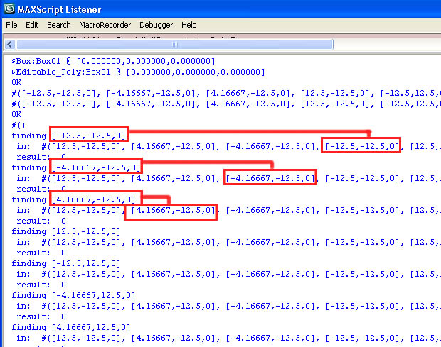

It's a rounding error, even
It's a rounding error, even if the point3 look the same in the listener they are actually different by really reaaaaaaally small margin. If you manually try subtracting the two "matches" that findItem reports as different, you'll see that the result is not [0,0,0] but something like [9.53674e-007,0,0]

i know the script is fine,but the problem is the "0" result when finding item inside the array.It should be found when we check on the print result...but why the result is always "0"
i adds a few line to show you the error...(it just the format thing) and i put image in the attachment to make it clearly.....I hope somebody can explain to solve my problem

What means not works?
What means not works? finditem() returns item index if found and 0 if not. In the 2nd example finditem() function returns 0 for all items. Simple test:
