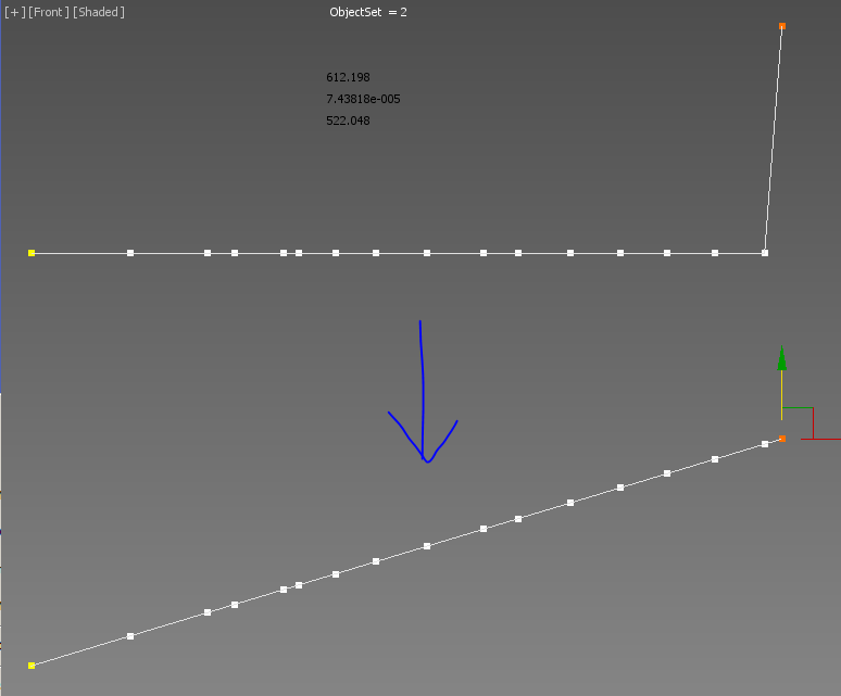

I made a little script to distribute spline knots on z axis evenly between first and last knot.
But for the script works fine I need to apply it 100 times (100 was a high value but is a random value)
If anybody can explain why ? Thanks

The script works. The knots are not aligned perfectly to straight line between the first and the last. The problem is when the DIFF.z = 0. If DIFF.z is 0 the SEC variable also is 0 and the knot will not be mvoed in Z direction.
Add print or format in the script and check the DIFF.Z. .

in fact if DIFF.z = 0 there is no need to use the script. :-)
