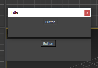

so i try it and It is working perfectly, it seems the problem was on dialog moved?
but if i run the script again while the one before is not closed yet using the button.
it create some uncloseable rollout instead
if possible i will remove that button on the final version of my script and using the standard close button
but again if you press the red close button it says error
-- Error occurred in TestDialog.close(); filename: ; position: 1208; line: 46
-- Frame:
>> MAXScript Rollout Handler Exception:
-- Unable to convert: undefined to type: String <<
position: 1208; line: 46 is >> setINISetting INIfile "Dialog" "Dock" theDockState forceUTF16:false
it seems that theDockState become undefined.
is the error just on mine?
