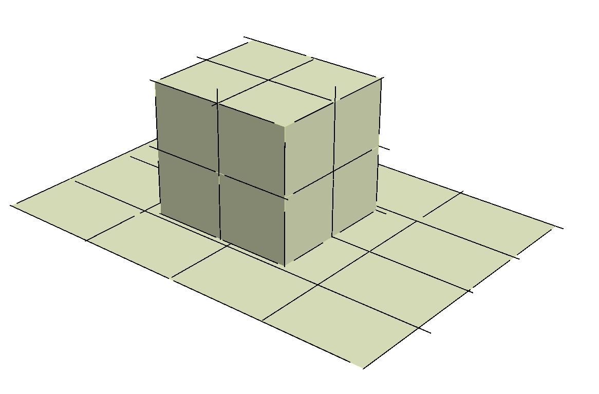

I try to make a little script to change randomly length of 2 vertex spline segments.
(to make sketchy effects like in capture )
It works but I want to have an undo.
So I made a button to store vertex positions when I want.
So I can tweak
If I want to restore vertex position I press "revert" button.
Boom, I can't make it working.
As always with arrays I reach very quickly my scripting limits :-)
Anybody can help ?
Thanks.
( try destroyDialog rRANGE catch() global rRANGE = rollout rRANGE "RANGE" ( button KEEP "Keep" width:120 height:25 spinner spB "range " width:80 range:[-100,100,0.0] type:#float spinner spH "range " width:80 range:[-100,100,0.0] type:#float button GO "GO" width:120 height:25 button REVE "Revert" width:120 height:25 on Go pressed do ( selec =$ for Aseg=1 to numsplines selec do ( verts = numKnots selec Aseg for i=1 to verts by 2 do ( knt1 = getKnotPoint selec Aseg i knt2 = getKnotPoint selec Aseg (i+1) vec= knt2 - knt1 Nvec= normalize (vec) setKnotPoint SELEC Aseg i ([knt1.x,knt1.y,knt1.z]- Nvec * ( random spB.value spH.value) ) setKnotPoint SELEC Aseg (i+1) ([knt2.x,knt2.y,knt2.z]+ Nvec * ( random spB.value spH.value) ) ) ) updateShape selec ) on KEEP pressed do ( selec =$ ZZ=0 knt = #() for Aseg=1 to numsplines selec do ( verts = numKnots selec Aseg for i=1 to verts do ( ZZ=ZZ+1 knt[ZZ] = getKnotPoint selec Aseg i ) ) ) on REVE pressed do ( selec =$ ZZ=0 for Aseg=1 to numsplines selec do ( verts = numKnots selec Aseg for i=1 to verts do ( ZZ=ZZ+1 setKnotPoint selec Aseg i ( knt[ZZ] ) ) ) updateShape selec ) ) createDialog rRANGE 160 250 setFocus rRANGE.spB )
