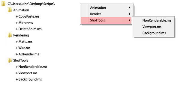

Attached is an image of the concept.
I've got it all working and whatnot.
My question now is.
Does anyone know how I could make this into a macro/hotkey so when you hit a hotkey the RCMenu shows...not the form/dialog?
Right now you have to right click in the dialog for the RCMenu to appear, I want to be able to hit a hotkey or a toolbar button that will make the RCMenu show.
You can test it out. Just change the dir variable to a folder directory which has subfolders with scripts in them.
