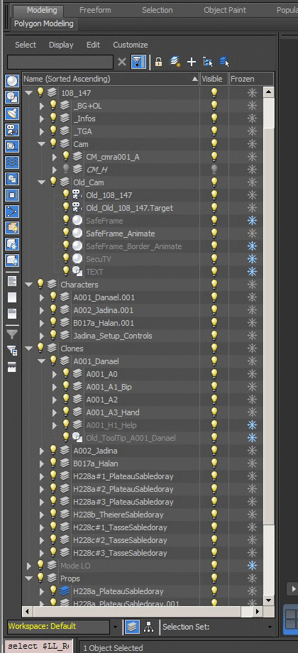

Yo mawou, thanks for all the explanations and the video you made, you're the boss! but as me, it's not possible to select layers inside another layer? this: ".nodes &objsArr" doesn't collect layers also?
fn SelectObjectsInLayer layerName: = -- list of layers founed to founded in the layer "Clones":
local objsArr
(LayerManager.getLayerFromName layerName).nodes &objsArr --is it possible to filter only the layers founded (first childs)?
objsArr -- return the selected layer
objsInLayerArr = SelectObjectsInLayer layerName:"Props"
select objsInLayerArr -- here the layers aren't selected
I thought that you want to select only the objects in the layer, not the objects in the nested layers.
Can you post an image to show how your layers are organized and which objects do you want to be selected?

Watch this video to see that the part of the script that selects the objects in the layer works properly: https://dl.dropboxusercontent.com/u/35093423/Other/Videos/Layrs_001.mp4
