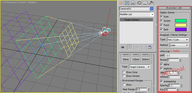

If I ever get around to finishing Render3D v2.0 here is what it will generally look like:
(click to get a closer look)
I am trying to avoid a modifier / plugin (as I've seen in other approaches). Instead I'm using CustomAttributes and Gizmos so a scene could be opened on any machine without errors caused by lack of plugin/modifier. (And without actually creating a pair of cameras; this will be done at render time)
