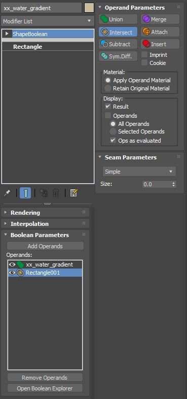

Hi
Since your spline object is flat, i would use a shape boolean, using a rectangle shape and setting the boolean operation to intersect
to speed things up i've added an optimize spline modifier at 50% and collapse it before doing the boolean operation.
go to Compound Shapes ,select your spline object click on "shpBoolean", choose intersect, then "Add Operands" pick your rectangle shape then wait for a few minutes...
