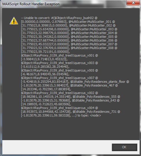

Hi, I tried to use the
Hi, I tried to use the selection as array but then I get this error message (in the file attachement).
Any idea, what's going on?
Thank you so much :)
Well, it was meant to replace
Well, it was meant to replace the whole line, not just part of it - note that it's AddNodesToContent, not AddNodeToContent.
Some of my scripts and MCGs :: 3ds Max SDK Intro for Scripters
It expects one node; when it
It expects one node; when it errors out, you're feeding it multiple nodes. There's no reason to make the variable global, btw. (actually it's a bad practice), and as it's used only once you don't even need the variable. Delete the first three lines and replace the highlighted line with
cnt01.AddNodesToContent (selection as array)Some of my scripts and MCGs :: 3ds Max SDK Intro for Scripters
